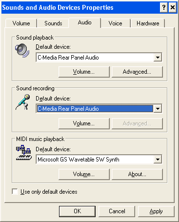

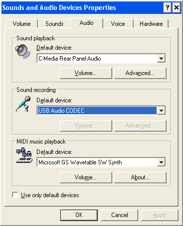

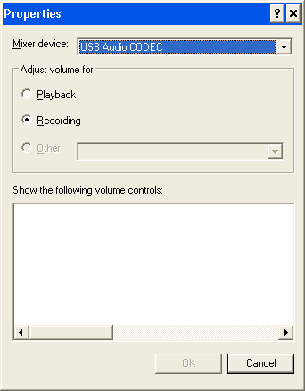

Here's what I didn't expect: There's no way to adjust the recording volume in Windows Mixer or Audacity.
"USB Audio CODEC" Screenshots
A Regular Sound Card
Of course, you can always normalize after you're done recording. Nonetheless, I expected to find a slider in Windows Mixer, just like any other sound card.
This could just be a limitation of the Microsoft's USB Audio CODEC driver (USBAudio.sys). I'm curious if Mac and Linux users have the same limitation.
Then again, I tried Ploytec's USB ASIO driver and got the same results, so maybe it's the nature of the hardware.
In the end, I guess you can always spin it in marketing terms: It's a feature- you never need to set your levels!

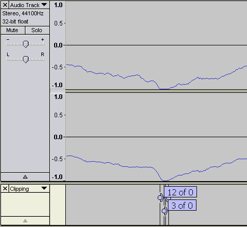

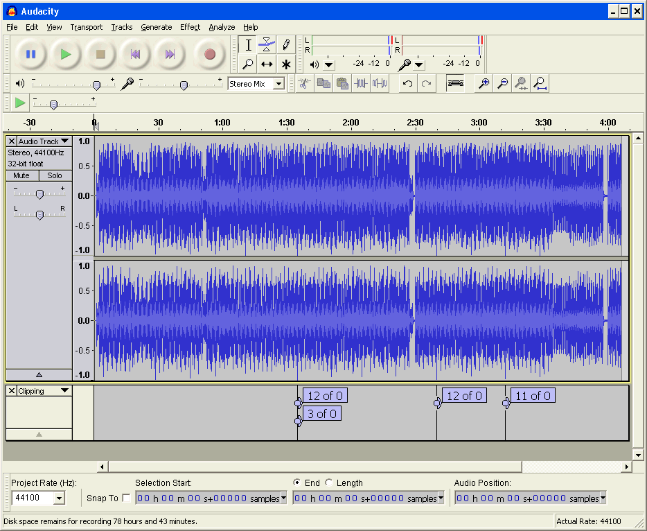

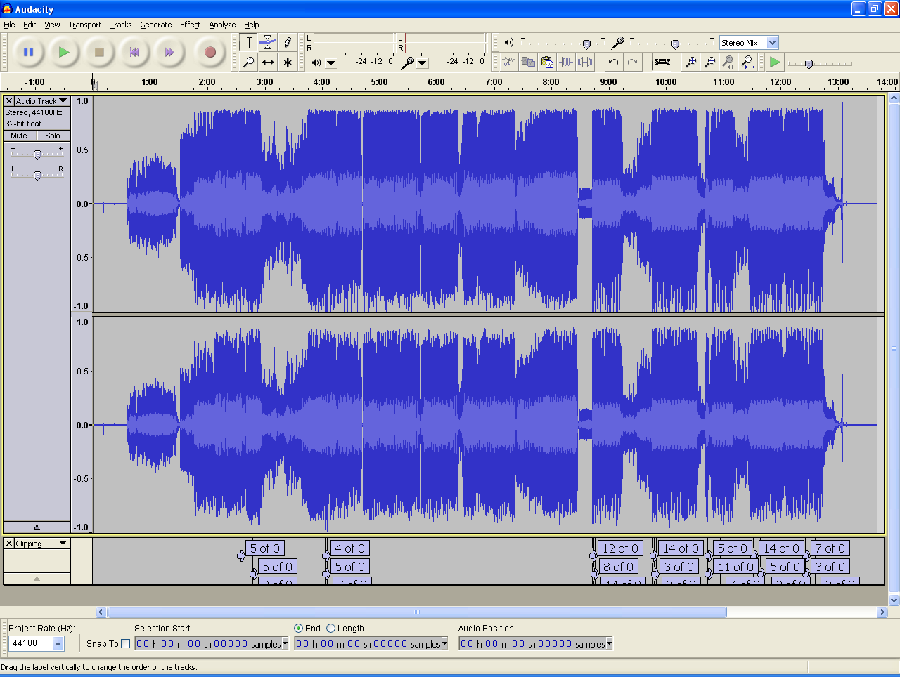

Houston, we have clipping!
Of the four albums mentioned in my "Preparations" post, Gorillaz clips throughout on the Audio-Technica. The rest play fine. Edit: I did find a single instance of clipping on Steely Dan's Aja, Side B.
Here's the FLAC containing the clipping seen in the first screenshot.
"Dare" from Demon Days
Side A (of 4) of Demon Days
This demonstrates the worst case scenario stemming from a lack of adjustable gain: The music is clipping and there's nothing you can do about it.

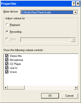

Help me understand this better, if you don't mind.
Every sound card I've owned in the last 10 years had two volume adjustments for the Line in. One is the "Playback" volume. The other is the "Recording" volume.
I assumed the recording volume was a software adjustment made after the A/D converter on a traditional sound card.
In any event, the recording volume is missing all together on the Audio-Technica and Ion TTUSB05 USB turntables (and I assume most others).

The reason there is no software recording level control is a limitation of the USB audio chip these turntables use (a Texas Instruments 2904 or related).  These chips have no software-adjustable level control and since the chip handles all USB communications, there is no way for the turntable designers to add one.  Bizarre, is it not?  I can only assume the chip designer was having a bad day.
You can't do anything about it in software, of course.  If the signal is clipped inside the ADC, you have had, so to say, your chips  .  This confuses the hell out of our users who see some or other piece of software which offers a worse-than-useless, after the fact digital attenuator and want to know why we don't too:

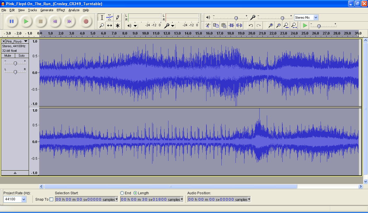

Check out the "On the Run" clip played through the Crosley CR249:
Pathetic, right?
The recording is a prime candidate for normalization no doubt, but this requires an extra step. The "record-and-be-done" crowd could benefit from simple slider to "set the levels" to an acceptable recording volume.
