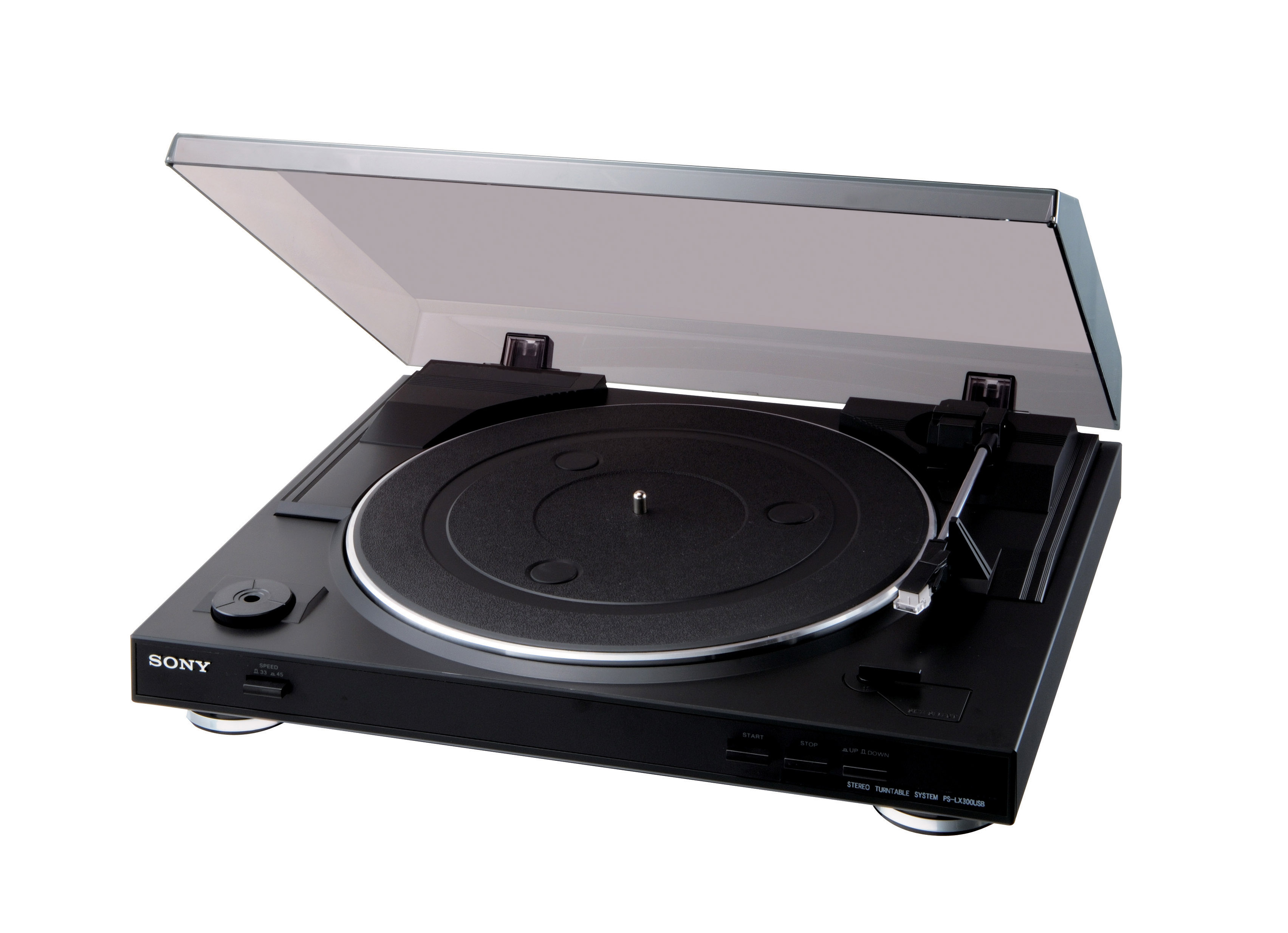

Let's look at what's available to consumers. I won't waste everyone's time with TT's featuring ceramic carts.
Audio-Technica LP2D-USB, Street Price: $100
  • MM Cart
  • No anti-skate adjustment
  • Cart not replaceable (kinda goes without saying with no anti-skate adj.)
  • Plastic construction
  • 0.25% Wow and flutter
Sony PS-LX300USB, Street Price: $100
  • MM Cart

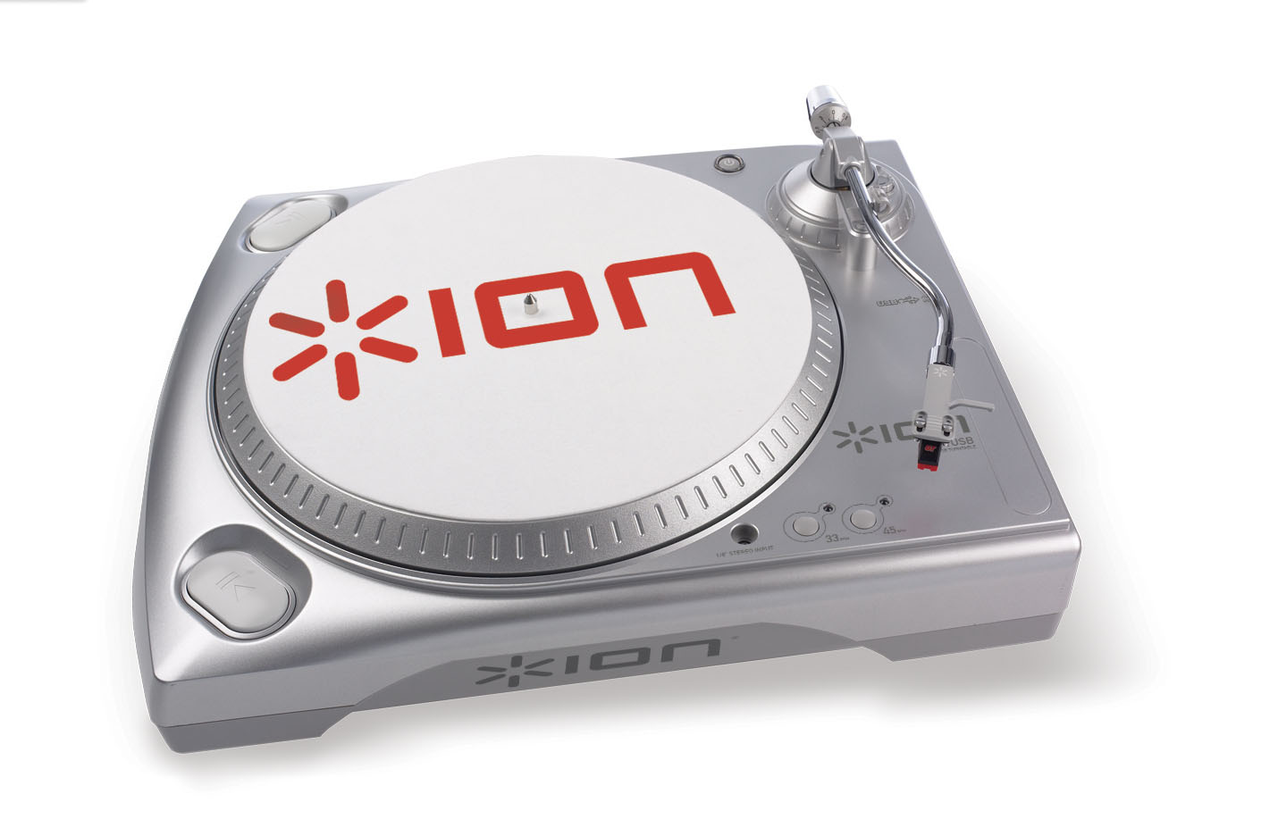

Ion TTUSB, Street Price: $125
Arguably the best consumer USB TT but still has serious drawabacks.
  • MM cart
  • Anti-skate adjustment
  • 1/2" Standard mount. However, numerous reviewers on Amazon report that replacing the cart with something decent, like the Shure M97xE, results in a background hum. It is reduced by placing aluminum foil under the mat in contact with the spindle!
  • Specs not published
And guess what? Ion Audio is a division of Numark- a DJ TT manufacturer.

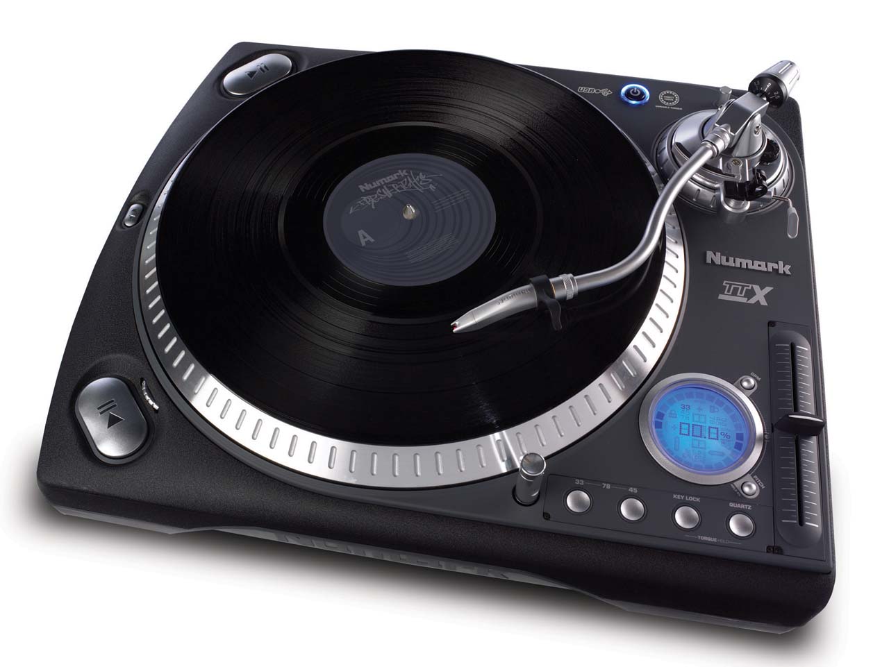

Compare these to the Numark TTXUSB, a DJ turntable...
Numark TTXUSB, Street Price: $375
  • Cart sold separately, 1/2" mount
  • Silicon rubber base
  • 0.15% Wow and flutter. Not great but compare to Pro-ject at 0.12%.
So there you have it, a quick snapshot of the USB TT market as it is today, where DJ TT's tend to come out on top.
