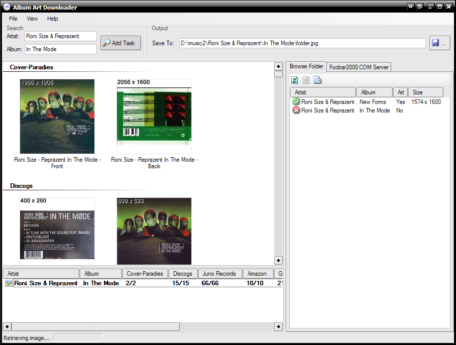

I've been working on this for a while, and I think it is time to let people start playing with it. This is a rewrite of the Album Art Downloader code, using .NET Framework 3.0.
Features:
  • Dynamically resizeable thumbnails
  • Thumbnail information
  • Sort by Name, Size or Source
  • Filter results under or over a specified size, or by maximum results for each source
  • Substitution syntax path to save images
  • Local files search that matches save pattern
  • Enable or disable scripts from the command line
  • New strongly typed interface-based script model; write compiled scripts in any .net language
  • Backwards compatible with existing scripts
  • Backwards compatible with existing command line parameters, including old CoverDownloader parameters.
For the graphically-minded out there, although this app isn't skinnable, the UI is all created in XAML, so if you want to grab the source and start editing the UI, please feel free. It is under the XUI folder in the SVN Repository
