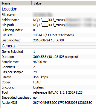

So, I "acquired" a bunch of silly hi-res FLACs a long ago and I finally got to review them, and noticed that all files had the exact same bitrate, which didn't make sense to me in the context of a lossless compressed stream: 4616kbps
So I got the the calculator and, sure enough, 96/24 stereo uncompressed PCM is 4608kbps. A little overhead for using FLAC as a "container" and there you go.
How did you check the bitrate?   Does that agree with file size?   Uncompressed it would be about 35MB per minute.
I've heard of that somewhere before, where a FLAC wasn't actually compressed.   But, you should be able to compress it to "real" FLAC yourself.
Re: Pointless and baffling encoding practices by audiophiles. Is this common?
@DVDdoug Judge yourself with this foobar2000 file properties screenshot:
And sure, I intend to re-encode, including a downsample and probably a depth reduction (after I'm done sifting, anyway).
I just wanted to share the absurdity.
EDIT: Also, MediaInfo:

I made a copy of another file, removed all tacks, pictures, RG, and all I could find, then "optimize file layout and minimize file size". Still 4616kbps. Encoding again to FLAC 0 gives me 3163kbps and FLAC 8 spits 2901kbps.
I don't understand FLAC encoding. I've looked over the level 0 equivalent settings to see what there's there.
Just like you, I don't know how to achive these PCM-equivalent-bitrate settings, but it sure looks like they went out of their way to get it. That makes me think that, actually, it's probably the original music store that's doing it as a way give audiophools something up their alley.
