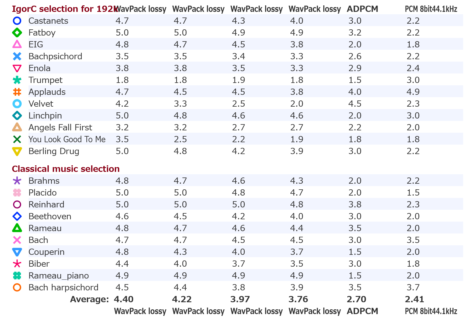

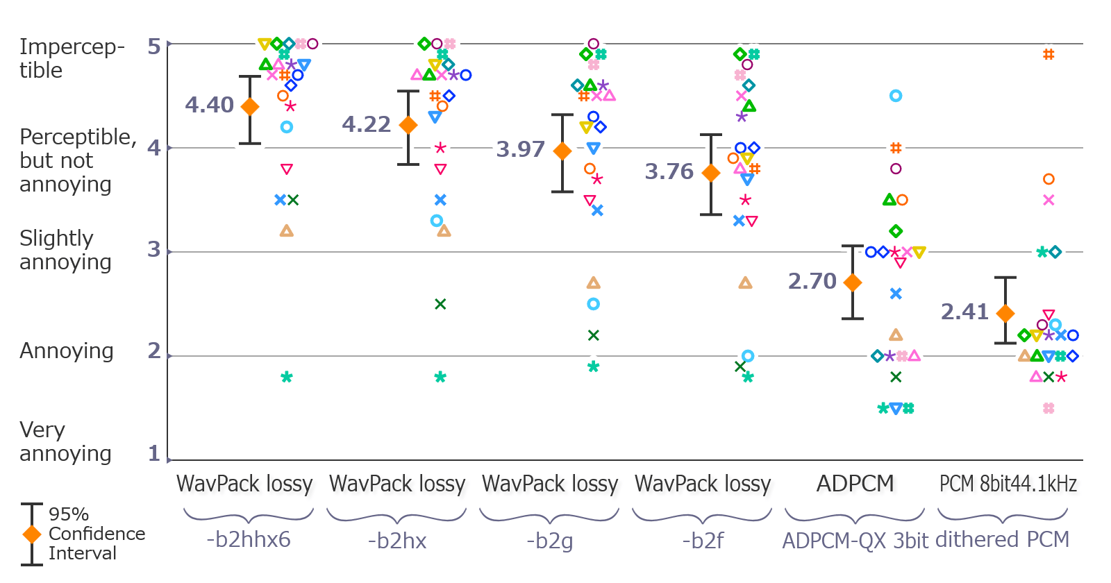

Reply #40
I managed to finish two sets of samples: IgorC and a small classical set. I can share these intermediate results here, and then create a separate topic when results are complete.
IgorC's 192kbps list
Classical Music
Few comments:
  • The classical music group samples do not present any particular difficulties. They are taken from records used for my large bitrate table, and my selection criterion was to choose a passage that I appreciated musically, without looking for possible encoding difficulties. The objective of this choice, made in 2020, was precisely to be able to evaluate future encodings on trivial passages. These samples logically should not allow differentiation of very high bitrate encodings, but they are very useful for obtaining a rating that approaches the judgment of a listener confronted with a normal listening experience. A second group will follow based this time on a Billboard hit parade.
  • The samples selected by IgorC are mostly known for the difficulties they pose to certain encoders. Castanets, Fatboy, Enola, Eig, Bachpsichord, Trumpet, Applauds, Velvet are classics that have been used here for 20 years or more. As an anecdote, I noticed afterwards that 3 samples were replaced by IgorC to conduct the 192 kbps test. I didn't understand in a first time why he had chosen spoken samples (Female Voice, French Ad). After checking again, I noticed these changes in his selection. Consequently, I tested the three alternative samples proposed by IgorC. I will only present the results of the 12 samples he had selected for the 192 kbps test.
I must admit, I'm quite proud of myself for making very few mistakes while ranking all these files. When the results are uncertain, I prefer not to insist, and if two files sound identical, I choose to rank them equally rather than strain my ears to detect subtle differences and increase the risk of errors.
Even with known problem samples, Wavpack lossy perform quite well at its lowest bitrate. But it's not transparent while classic lossy encoders are able to be close to that state with the same samples (see https://hydrogenaud.io/index.php/topic,120007.0.html). Moreover, the poor performances with trumpet sample is a big warning that 200 kbps with Wavpack can lead to strong distortions. It should be more clear with a selection dedicated to problem samples. On the other side, the classical music group also reveals that 200 kbps could also sound very well to the end user.
Adding a fourth encoder was finally a good choice (at least at this bitrate). Porcus was right to insist on that matter. And default (-g) setting really fills the gap between the fastest and the high mode. Difference is not always audible but at the end there's a clear trend. The high (hx) mode seems to be the sweet spot here: excellent encoding speed and audible improvement over inferior settings. The highest mode (hhx6) also brings a small overall improvement but effect can be very significant on some samples (Couperin, Velvet, You Look Good To Me).

I did some visualization rework of the Guruboolez's great test (what I did was reordering, combining, and that's it)
machine-readable text:
Spoiler (click to show/hide)
Re: Need advices for listening tests (Wavpack lossy)
Reply #47
Thanks Kamedo, it's much better!
