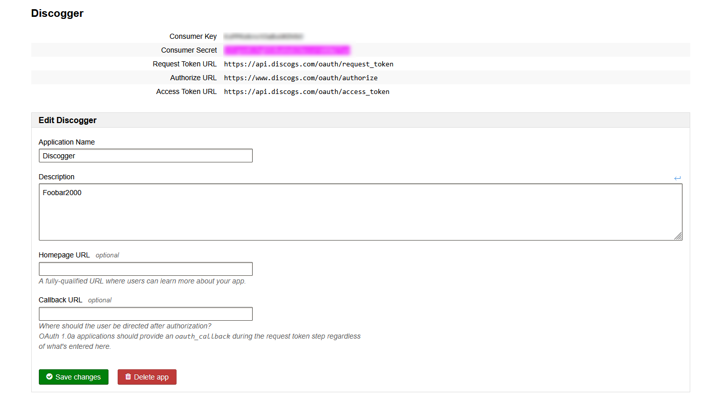

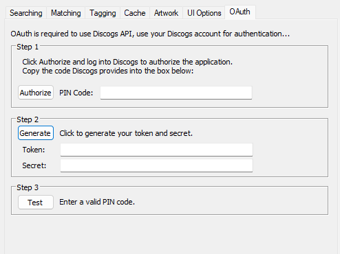

Hi folks
running windows 7.
Tried so many different methods to enable TLS 1.2. It says it is in Internet Options - Advanced Settings along with TLS 1.0 and 1.1,
Whenever I try to configure with 0auth nothing happens when I try to retrieve pin. I login with browser and still nothing happens.
Faced with error every time: "(FATAL) Error: Network exception: Network authentication error: The function requested is not supported (80090302) (url: https://api.discogs.com/oauth/request_token?oauth_consumer_key=xxxxxxxxxxxxxxoauth_nonce=xxxxxxxxxoauth_signature=xxxxxxxxxxxxxxxxoauth_signature_method=HMAC-SHA1&oauth_timestamp=xxxxxxxxxxoauth_version=1.0)"
replaced numbers with Xs in case they're sensitive.
Any ideas? Thanks.
