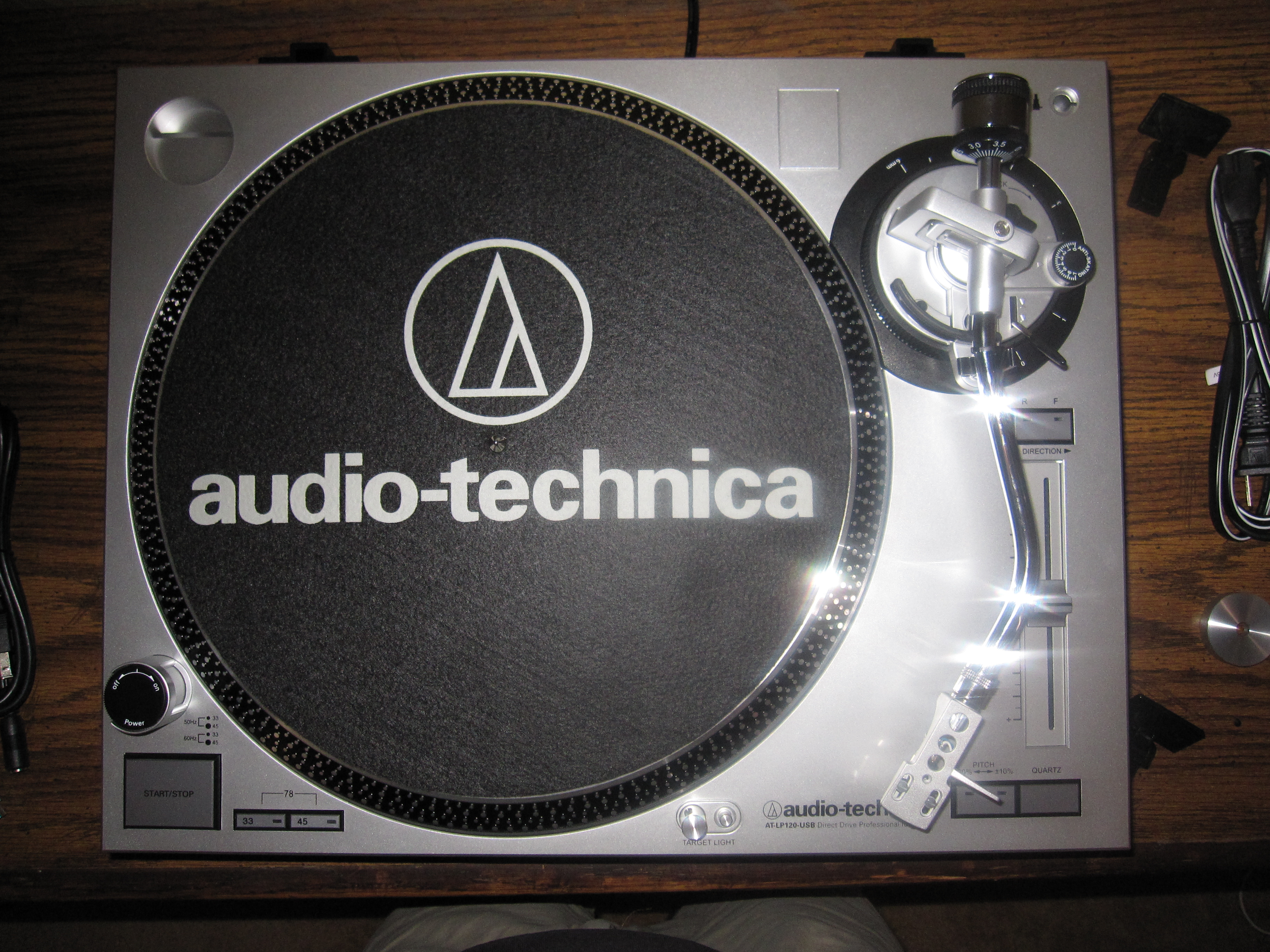

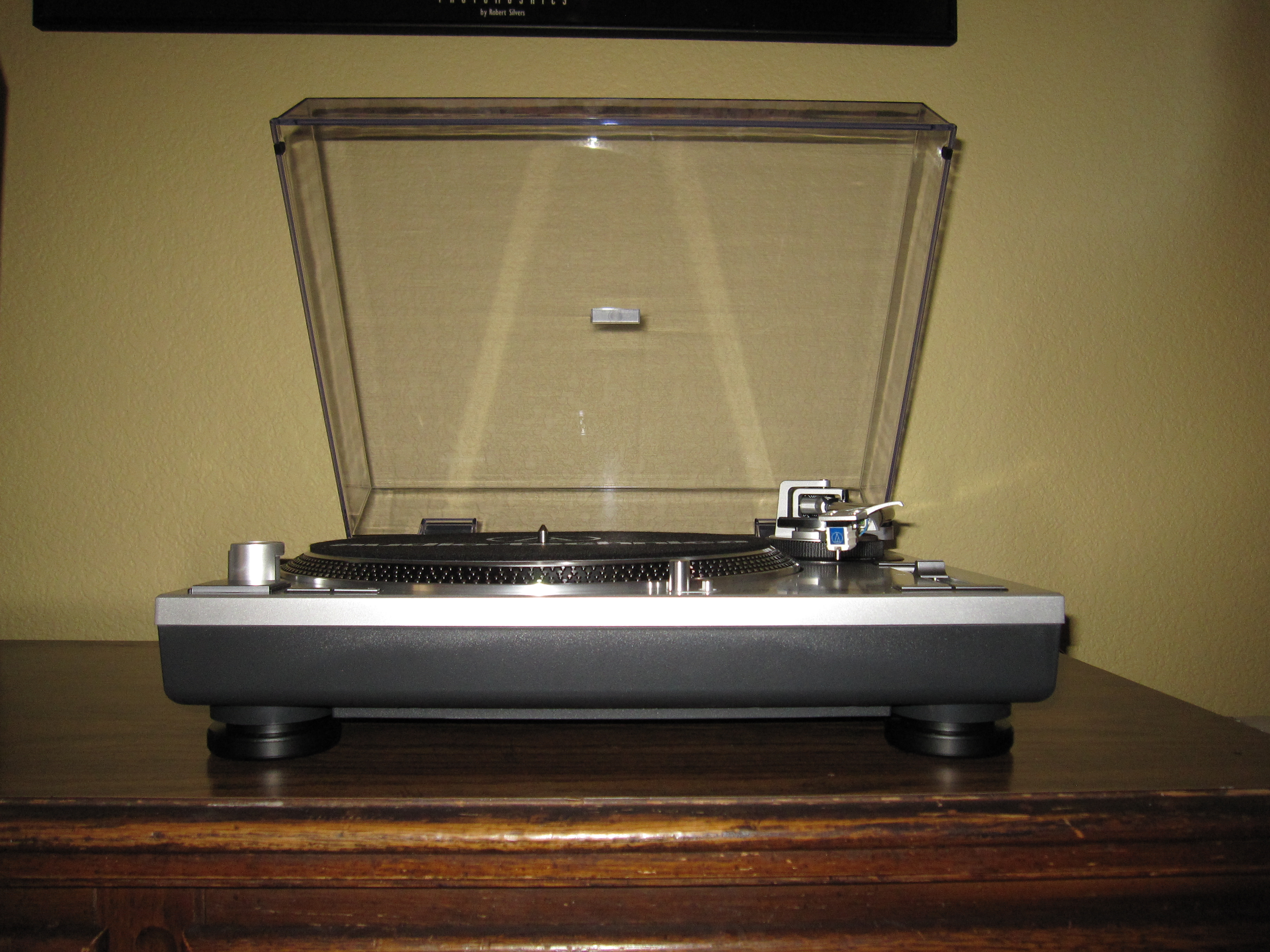

Photos

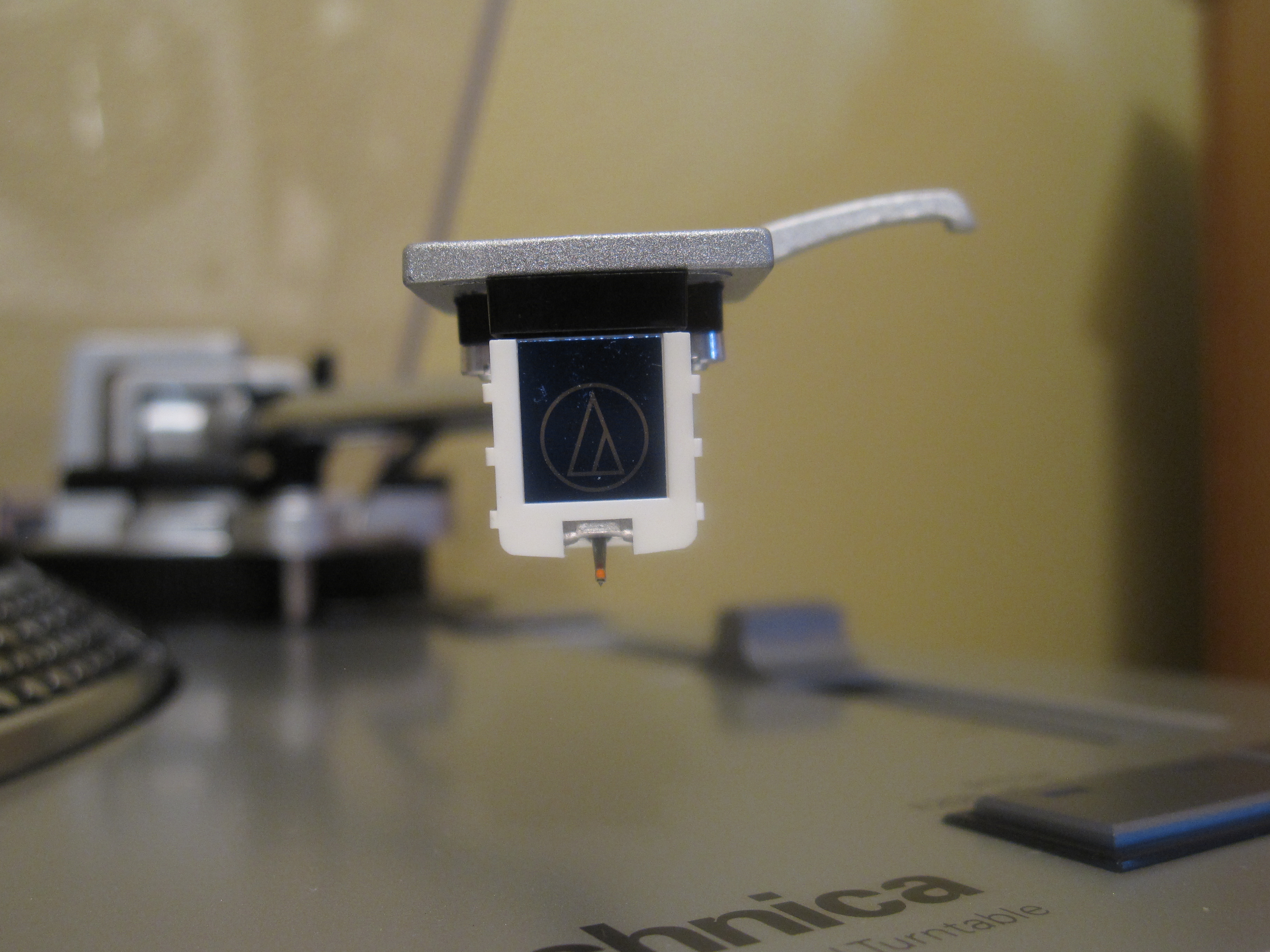

Audio-Technica's USB version of their AT-PL120 did much better on the trackability tests LPs than Stanton's T.92- likely thanks the elliptical stylus tip on its ATP-2 cartridge. However, I couldn't hear the difference between the AT and the Stanton once I normalized the samples.

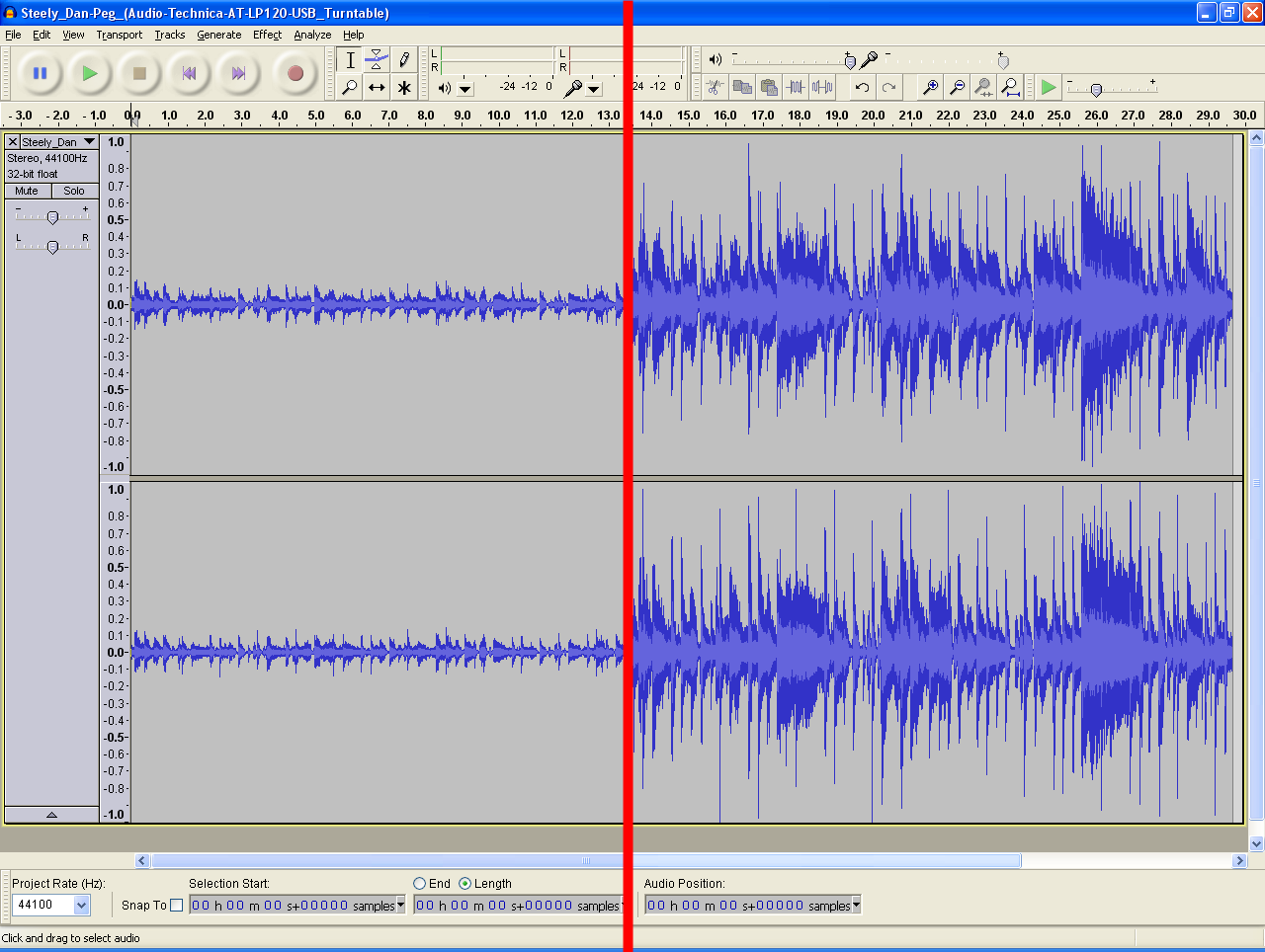

A final observation: Normalization is an absolute requirement when using the LP120's A/D converter. Steely Dan peaks at -10.8dB. We talked about this at length already but I think the AT-LP120-USB could be the poster-child of why a pre-ADC adjustable gain would be so useful.
