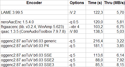

I am simply amazed about the speed gain!
I compared different encoders, and for Ogg Vorbis, specifically, several specific builds, encoding a whole CD image (697 MB) on an AMD Phenom II X6 1045T, 2700 MHz. Times taken with ptime; best of 3 consecutive runs.
Germany uses a decimal comma. Basic oggenc2 builds are from RareWares.
That shouldn't leave any doubt that Ogg Vorbis, fine tuned by Lancer, is now probably the practically most efficient audio encoder, regarding a weighted relation between quality efficiency and speed efficiency. The FhG AAC encoder is close, but lacks of bitrate tuning flexibility (quite a large gap between VBR presets 4 and 5, targeting at 128 or 192 kbps).
