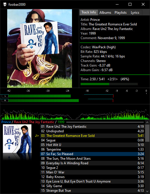

Current dark theme that I'm running the most.
Based on the very well done Catrox theme...
... and thanks to the foobar community that keep on developing awesome tools/panels.
