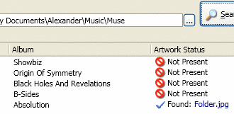

  • Analyse files to find Artists and Albums from tags, and check if album art is already present.
  • Analyse folder and file names to find Artist and Album names based on a path pattern, and check for album art.
  • Read your foobar2000 media library or playlists to find Artists and Albums, and check for album art.
  • Checks for existing album art embedded in file tags.
