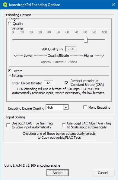

Now that multi-terabyte drives are cheap and commonplace, I rip my CD's to wave, then use the latest LAME encoder with LamedropXPd V3.1 to encode to 320/CBR. Every time I start Lamedrop, it reverts back to it's "standard" settings. Is this normal, or am I doing something wrong?
Again, not a big deal because lamedrop makes it easy to change the settings. Here's a pic of how it starts on the left, and how I set it on the right.

Your using an older version. The latest version uses lame3.100 and has had the SoX resampling routines removed as the integration into the file input code was causing unpredictable behaviour, such as you have discovered. I've not received any reports of any issues with the current version.

John; I went to Rarewares and downloaded the latest version before I made the post to check that. Those screen shots are from V3.100. And I'm also using the latest version of LAME itself.

The first two images in your original post are not from the latest version on Rarewares. The Encoding Options screen would look like this:
The first versions using lame 3.100 did use the SoX resampling, as also shown on your first images. I replaced those a couple of months later with compiles that had the SoX routines removed, as mentioned, hence the blank space towards the bottom of the above image.
