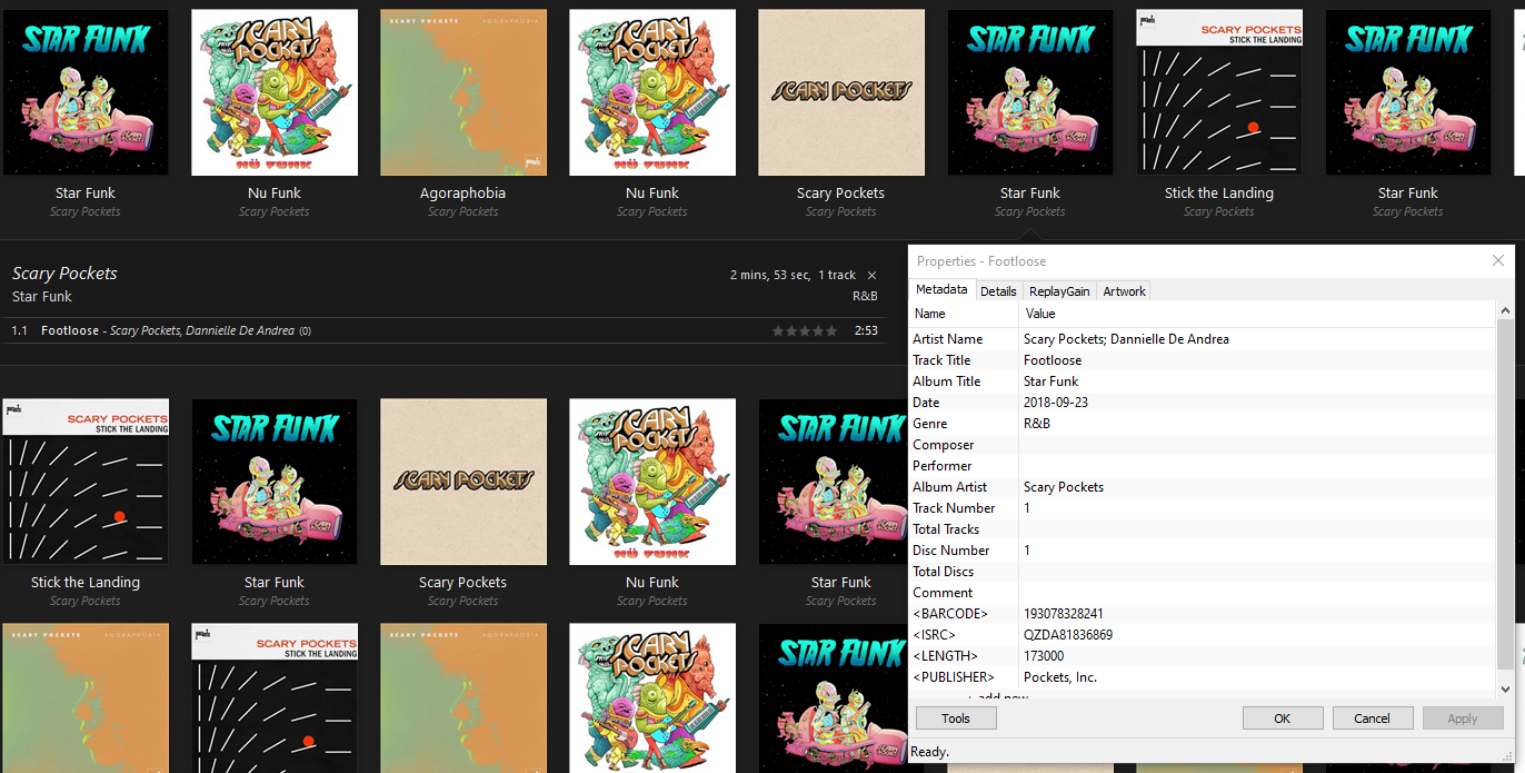

For example, all the songs inside of the "Star Funk" album do have the album artist tag as Scary Pockets:
The best way to fix it, is the artist name is actually Scary Pockets. In Properties window, you may want to cut/paste the existing multiple field artist tag into Performer which is correct tagging.

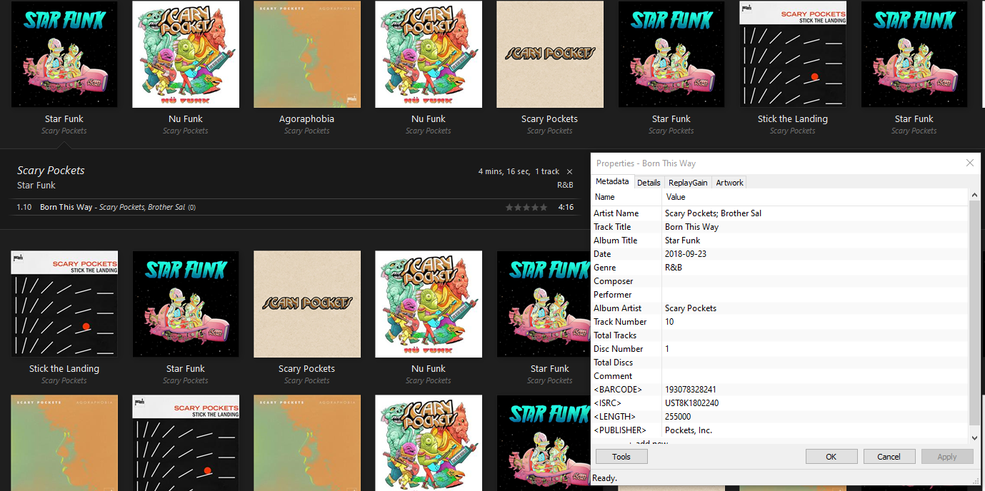

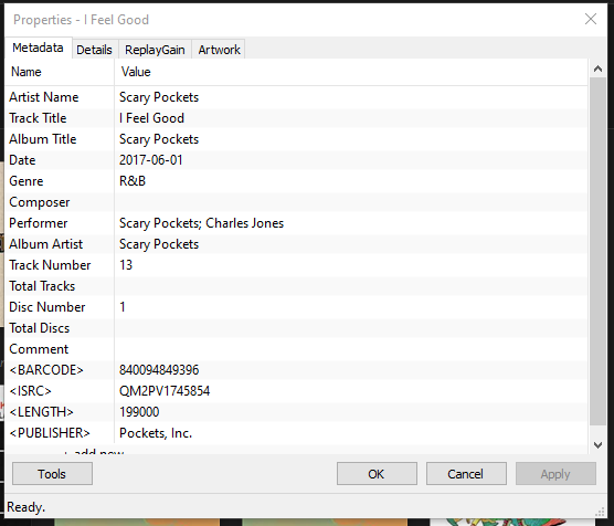

I don't understand what I need to do. I tried to follow your instructions, and with the following two songs I moved what was in the artist tag into the performer tag and then updated the artist tag to match the album artist tag:
And this did not work. They are still showing up as separate albums. They are not separate albums.
